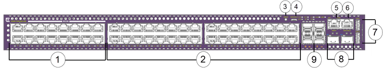

The following diagram illustrates the components of the front panel of the 5420F-8W-16P-4XE switch.
The front panel of the 5420F-8W-16P-4XE switch includes:
8 10/100/1000BASE-T full-duplex (FDX), half-duplex (HDX) 802.3bt Type 4 PoEMACsec-capable ports, 16 1000BASE-T FDX/HDX Type 2 PoE+ MACsec-capable ports.
Mode button for port LED control. Port LED mode indicators (SYS, SPD, STK, and BT). Switch LEDs for system power (P1, P2), fan (FAN), and System Locator LED (LOC).
The software only supports SYS and SPD LED mode indicators. STK and BT LED indicators remain off.1 Micro-B USB console port
1 RJ-45 management port
1 RJ-45 serial console port
2 Type-A USB ports
2 SFP-DD Universal Ethernet ports (labeled U1 and U2)
4 1/10 Gbps SFP+ ports
The back panel (not shown) includes two fixed fan modules, an AC power inlet connector, a power supply slot, and a grounding lug.

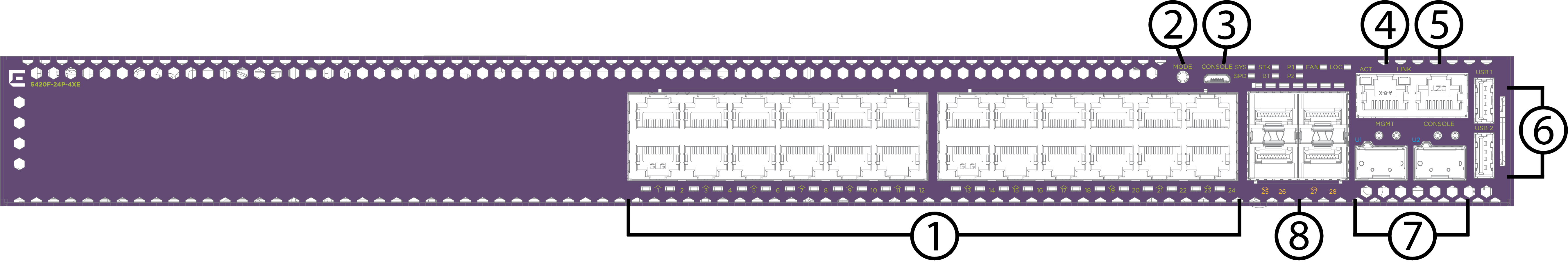

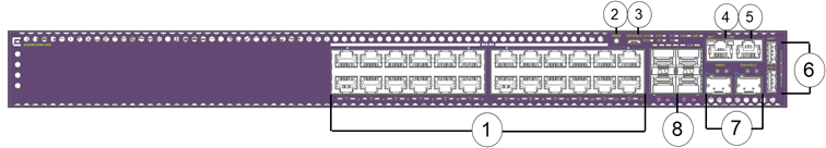

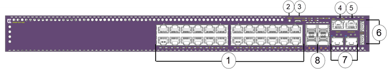

The following diagram illustrates the components of the front panel of the 5420F-24P-4XE switch.
The front panel of the 5420F-24P-4XE switch includes:
24 10/100/1000BASE-T FDX/HDX 802.3bt Type 2 PoE+ MACsec-capable ports.
Mode button for port LED control. Port LED mode indicators (SYS, SPD, STK and BT). Switch LEDs for system power (P1, P2), fan (FAN), and System Locator LED (LOC).
1 RJ-45 out of band (OOB) management port
2 Type-A USB ports
The back panel (not shown) includes 2 fixed fan modules, an AC power inlet connector, a power supply slot, and a grounding lug.

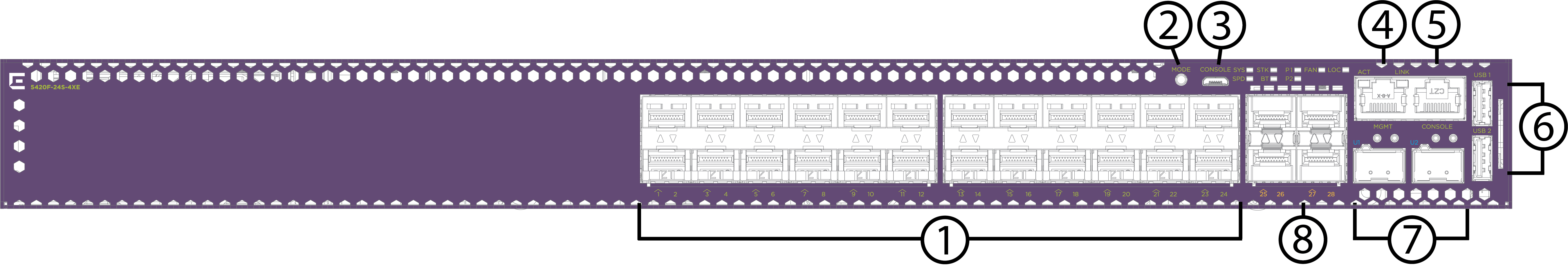

The following diagram illustrates the components of the front panel of the 5420F-24S-4XE switch.
The front panel of the 5420F-24S-4XE switch includes:
24 1000BASE-X SFP MACsec-capable ports.
2 Type-A USB ports
4 10 Gbps SFP+ ports

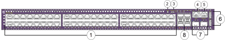

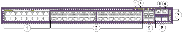

The following diagram illustrates the components of the front panel of the 5420F-16MW-32P-4XE switch.
The front panel of the 5420F-16MW-32P-4XE switch includes:
16 100Mb/1GB/2.5GB 802.3bt Type 4 PoE ports.
32 10/100/1000BASE-T FDX/HDX Type 2 PoE+ MACsec-capable ports.
2 Type-A USB ports
The back panel (not shown) includes three fixed fan modules, a power supply slot, an AC power inlet connector, and a grounding lug.

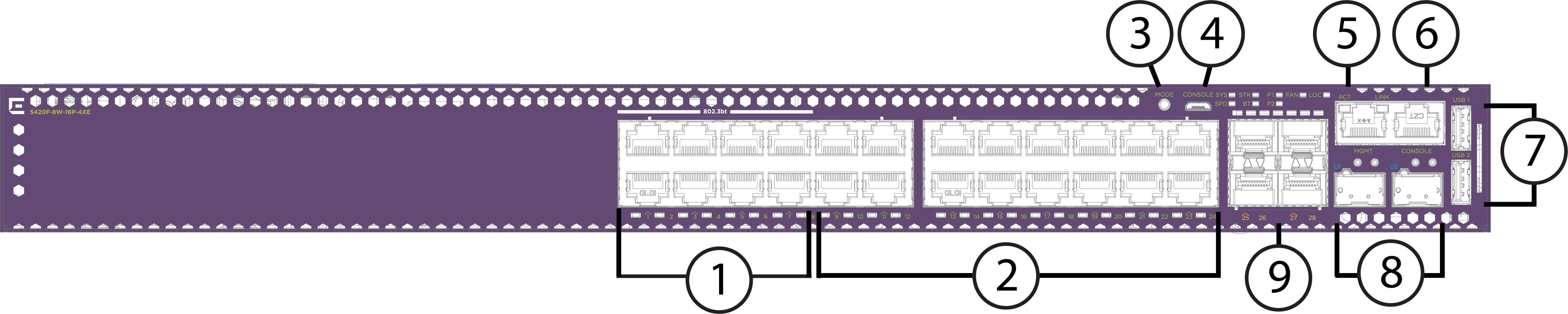

The following diagram illustrates the components of the front panel of the 5420F-16W-32P-4XE switch.
The front panel of the 5420F-16W-32P-4XE switch includes:
16 10/100/1000BASE-T FDX/HDX 802.3bt Type 4 PoE MACsec-capable ports.
2 Type-A USB ports

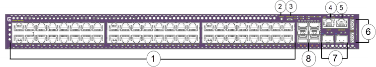

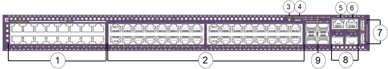

The following diagram illustrates the components of the front panel of the 5420F-48P-4XE switch.
The front panel of the 5420F-48P-4XE switch includes:
48 10/100/1000BASE-T FDX/HDX Type 2 PoE+ MACsec-capable ports.
2 Type-A USB ports

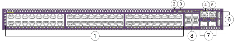

The following diagram illustrates the components of the front panel of the 5420F-48T-4XE switch.
The front panel of the 5420F-48T-4XE switch includes:
48 10/100/1000BASE-T FDX/HDX MACsec-capable ports.
2 Type-A USB ports
The back panel (not shown) includes two fixed fan modules, a power supply slot, an AC power inlet connector, and a grounding lug.

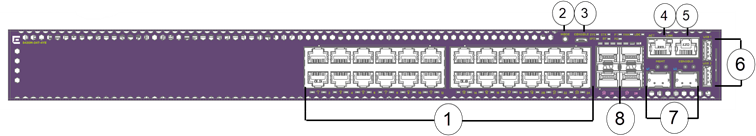

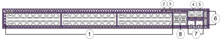

The following diagram illustrates the components of the front panel of the 5420M-24T-4YE switch.
The front panel of the 5420M-24T-4YE switch includes:
24 10/100/1000BASE-T FDX/HDX Type 2 MACsec-capable ports.
2 Type-A USB ports
4 1/10/25 Gbps SFP28 ports
The back panel (not shown) includes a removable fan module, two power supply slots, and a grounding lug.
